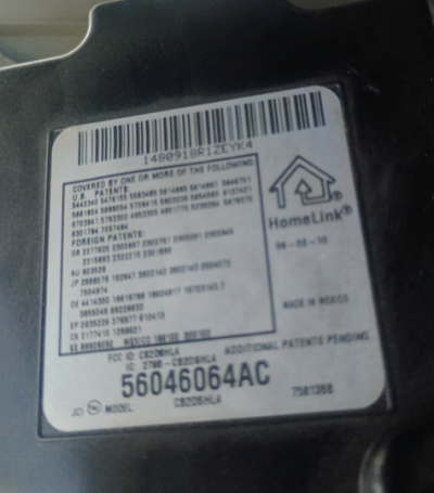

What part is needed to fix the compass? I'm tired of the calibration "Cal" being on my instrument cluster.

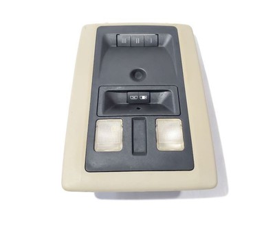

Compass module located in the overhead light. It looks like this if you don't have the HomeLink buttons. Do you have the garage door opener built in?

I have one that I just picked up from the Pic A Part, off of a 2012. Not sure if it works, but, looks good. Part # 56046062AC. In fact, I have the whole overhead light assy. Doesn't have the Home Link buttons. 1 mounting tab is broken, but, can be plastic welded.
2012 should be the last compatible year for yours so you should be good to go.
