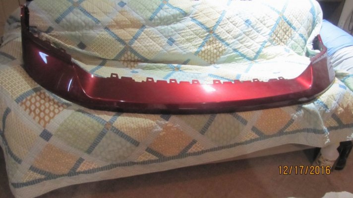

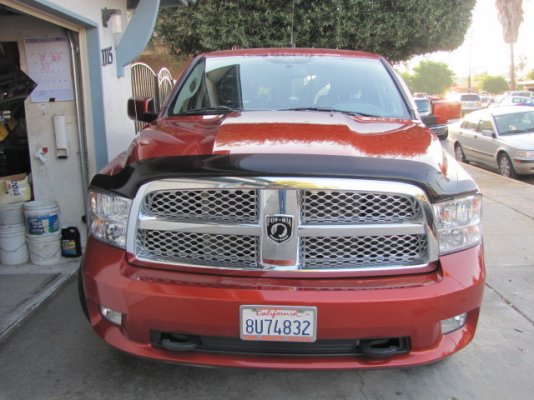

If you have the tools & the time, you & at least one other person can do it
You never mentioned are both front sections made of Plastic or Metal
2012 Grille & valance are shaped squared off at the bottom corners, just like the grille emblem at the top
2013 Grille & valance are shaped differently, the bottom of the grille corners are cut off, just like the top of the grille emblem
GTyankee
Nov 2, 2020
12,391
17,459
El Cajon Calif. 92021
3.0 ecodiesel
I would get the grille that you want to install
Then remove the current grill & set it aside
Then remove the bumper valance & set it aside
Now test fit the replacement grille
You can remove the grille inserts to make the grille lighter
