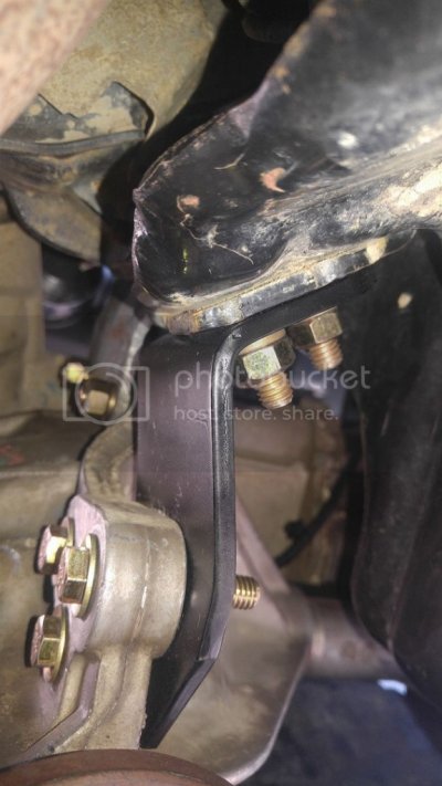

Can you send me a pic of the driver's side rear bracket you are talking about, we've got the front driveshaft already. Any issues bolting the electric rack to the '11 housing?

Since you asked haha. Its very straight forward doing the swap. CV shafts go right back on. Front driver and passenger side brackets will bolt right on. The drive shaft will need to be swapped but you already have that.
The actuator will plug right back in from the older diff. Mine worked, should you have a bad actuator i'm sure that you could put the one from the 14 diff on the older diff. They are the same size and design.
I have a feeling you will run into a problem with the rear driver side bracket. My bracket was designed for a 6" lift. Without getting the other brackets hooked up to see where you are at you might have to cut the diff bracket on the frame and drill new bolt holes to make enough room to build a custom bracket.
Here is a pic of the bracket i have to get a rough idea.
A full axle swap for the rear end im not sure about. I dont know if the driveshaft yokes were smaller or larger for the older design.

Its cool. The front driveshaft is smaller on the older diffs, therefore the yokes dont line up. We tried to just swap the yoke from the 14 onto my 09 diff but the rubber seal was too small and the seal from the 14 didnt fit the 09 diff.
Im sure there is a way around that but that was my experience. Switching the driveshaft is the easiest route. They aren't too expensive down here. Not sure about up there. I got a used one for $85.

Thanks Kris. After reading your post I went out and got under mine to look at it really close.You're right it looks like the drivers side rear bracket and mounting points are totally different. Were the mounting ears on your original front diff housing angled? The ears on the diff I bought have the ears basically vertical to the housing while my original back mounting ears are sitting on an angle. I see what you're saying about the front driveshaft,the pinion yokes are noticeably different. Do you still have your original front diff,and how much do you want out of it,lol.
yes the 12+ are more of an angled mount. Pre 2012 are vertical. Not sure why they changed them.
Honestly you might be better off just going forward with fabbing up a bracket and getting a driveshaft at this point since you already have the diff.
