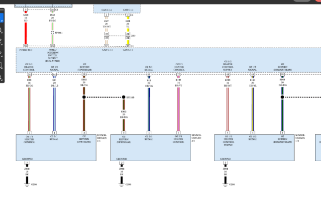

I found this link in the 5th Gen forums. It doesn't specifically state its for Classic or 5th Gen. I guess it will get me close. Looks like pins 41 and 42 on the PCM.

I have the 18 ram 1500 diagram and it should be the same as what Ken posted (& 19-24 classic DS) ...
You can also use the schematics with the Mopar Connector Repair site...
  • CATALYST-MONITOR-SYSTEM---3.6L_5.7L---8-SPEED.pdf

Thank you. That is a little different to the one in the link I posted above. I'll have to get in there are see if it is like either of them.
They both show pin 4 on sensor 2/1 as Dark Blue & Green with wire number K43 going to pin 41 on the PCM. SO n theory that should be right.
They both show pin 3 on sensor 1/1 and 2/1 shared and labelled K902 with Brown & Dark Green wire. On the above diagram this goes to pin 19, but on the 2021 diagram it shows pin 40. The wire colours will hopefully give it up.
