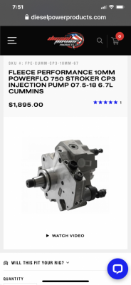

Well I’m guess I am buying this.
didn’t want to do it yet but I guess I have to, hope it works.5F7225AB-BB36-4A46-A68C-656459739AB9.png

Been out of the cummins world for a couple years but just getting back into it as i inherited a 2011 deleted 3500 srw. I know back a few years ago there were quite a few options for cp3 out there i would shop around a bit plus should have some 4th of July sales this week as well

I have been planning on upgrading it for a while just didn’t want to do it yet.
