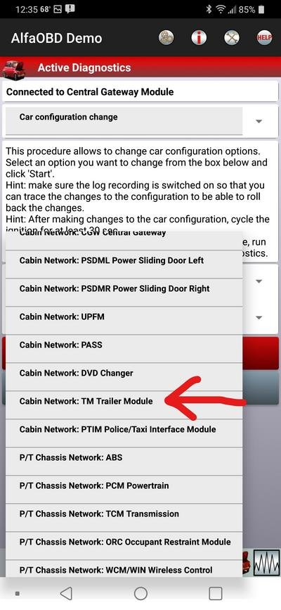

I plugged into my truck earlier with the DEMO version, just to make sure they will talk. I looked through where the trailer brake controller should be listed, and these are the two closest options I could find. Would one of these be it?

Actually, it works from 2005 MY on up, just not everything on every year. I've used it on both my 2010 1500 and my sons 2012 2500 successfully for various things. I'm mot sure if either of those settings are what you need though, both our trucks already have them. I'm pretty sure someone else on here enabled it, but I think it was referred to as ITBM. In the first post of the ALfaOBD thread is a link to known working settings, suggest browsing thru those, it may point you in the right direction. Hope it helps

Just looked through all the options, a little more slowly this time, and saw ITBM. I'm pretty sure that is it. Going to buy the app and play this weekend. I've seen a few other things I would like to play with also.
