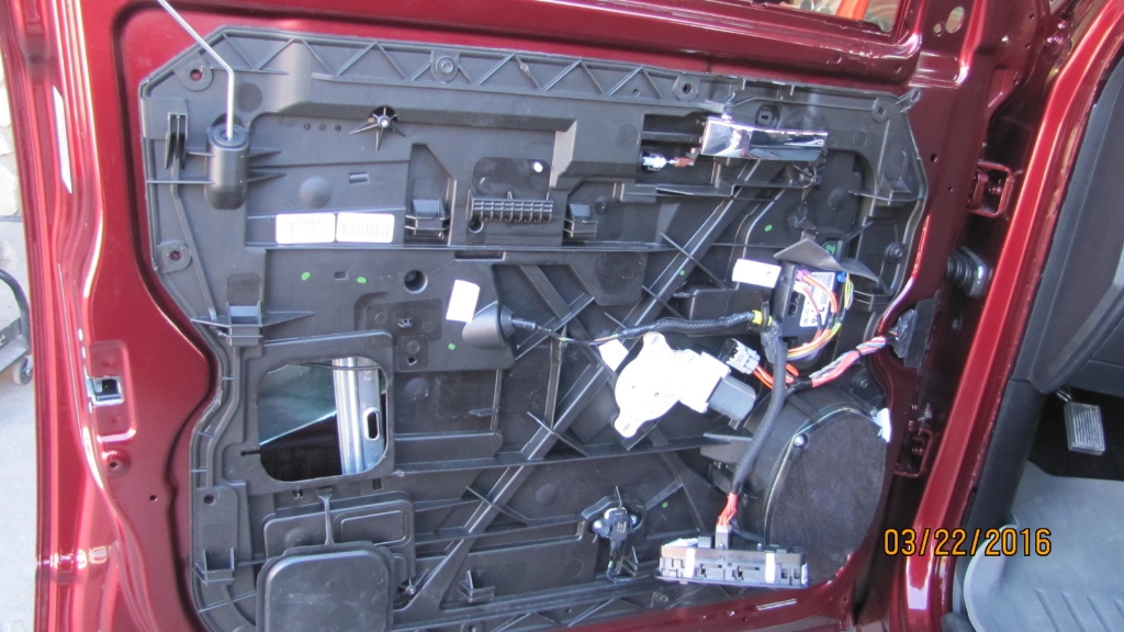

You might remove the inner door panel on the drivers side
There are several videos on how to do that
Most of the wiring is now exposed & you can see the metal rods that work the door locks.
Connect the door master switch back up, with the panel set aside
Work the different buttons on the master switch & see what is working or not.
You will notice a rubber square flap, maybe 5 X 5
roll up your window. Then press the master switch LOCK button & listen to any noise. pressing the Lock & Unlock button should make the Door Lock Actuator move.
You can look at the door latch on the edge of the door & i think you can see something moving if you have electricity going there.
Do NOT bend those metal rods, they seem rather fragile
