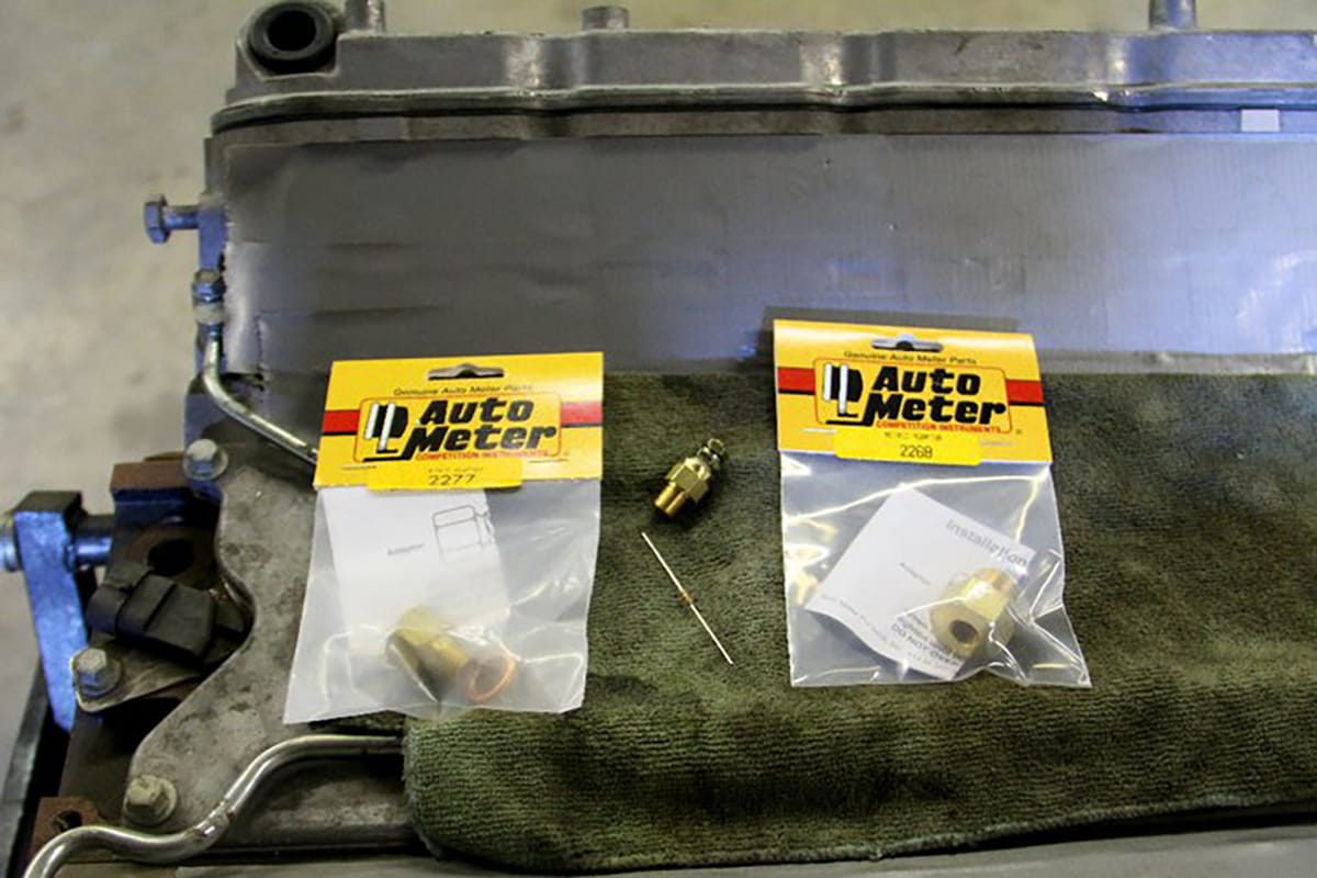

I would just put a mechanical oil pressure gauge on it, you can tee it from the oil pressure switch located on the oil filter housing, you'll get a more accurate reading.

You'll get the most accurate reading with a mechanical gauge you're getting the oil flow from where the mains and rods are getting their oil supply from.
