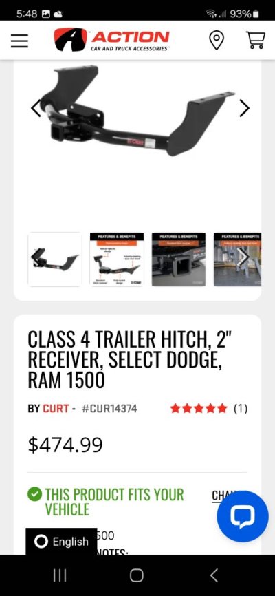

When I look online I find lots of options that say they fit my truck however when I look under the truck it seems the bumper also bolts onto the main bar that the tow hitch is on.
As you can see in the attached pictures the Mopar one has the extra plates on the front side. It also has a bolt hole on the top similar to the location of the large bolt on my current hitch!?
I don't was to buy one and end up with the same issues.
Anyone else been through this or have some advice on the easiest and most cost effective way of solving this?

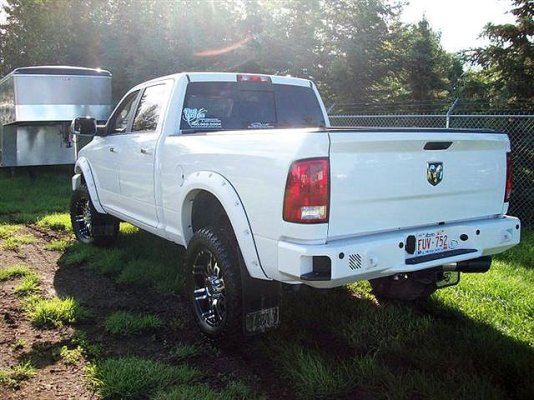

I would leave the hitch as is and work on getting the bumper to fit properly. Bullet Proof in Red Deer makes lots of choices and they will ensure it fits, if you can send the Rough Country back. If you can't send the Rough Country back you may want to modify it so it fits correctly. Rough Country is expensive and tend to make poor quality, poor fitting stuff. For sure never buy any of their lift or suspension stuff.
2010 Dodge Rear Bumper
MSRP: $1,595 CAD
With Sensors: $ 1,745 CAD
Rear Bumpers are designed to utilize the existing Factory receiver hitch
  • Comes Standard with 2 hidden reverse lamp mounts
  • Integrated side steps mounted 6" below the top of the bumper
  • Side steps and center step come standard with custom fit polyurethane coated inserts
