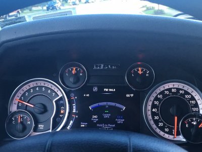

Hey y'all. today i upgraded my base model speedometer cluster for the premium cluster with the 7" LCD screen . i used a cluster from a seller on Ebay who includes mileage and engine hours programming into the premium clusters he sells.
was 100% "plug and play" . it is a 2013 cluster that i put into my 2013 truck. everything in the new cluster works, with the exception of the compass, since my truck never had a compass.

How much if you don’t mind me asking? So you put your mileage and engine hours into the new one?? Nice upgrade!
2013 Copperhead
2013 Copperhead
Oct 19, 2017
i paid $325 including the programming. yes, you just tell them what mileage and engine hours and they program it for you. the ebay seller is clustersurgeon very happy with it. it arrived in 2 days from MS to NY
the car computer also has the mileage and hours, but its stored separately. why they didnt design it to have the cluster display the mileage from the computer, i dont know. but you definitely want the computer miles and the cluster hours to agree, or at least be real close.
