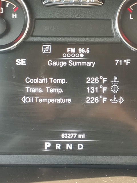

Hey guys, this is my first post. This seems like a knowledgeable bunch of guys who may have the answers that I need. I have a 2013 ram 1500 with the 4.7 engine. The truck only has 63,000 miles and so far has been a perfect truck. The issue started when I had to make a 225 mile trip over the weekend. The truck has always ran at 204-206 degrees, even in hot summer temps. But when checking the temperature on this trip it was running at 222-226 degrees, at freeway speeds. Outside temperature was only 70 degrees so I don’t understand what changed, it has never ran this hot. It seems that something in the cooling system isn’t working as it has been. Checked coolant in reservoir and radiator and both are where they should be. Also, transmission temperature was only running 130 degrees, which seems to be a huge differences in temps. Thanks for any ideas.

Thanks for the reply. I was parked when this picture was taken, however it was the same as when running. Was running empty and not towing anything. Radiator/condenser area looks very clean to me. A few little small bugs, bot otherwise very clean and fins look good. The transmission temp is normal for what it's alway been. The highest ive seen it climb is 145-155 in humid summer weather.

Interesting, i wonder why our trans temps are so very different for the exact same truck.
Seriously though, replace your thermo and you should be good to go.

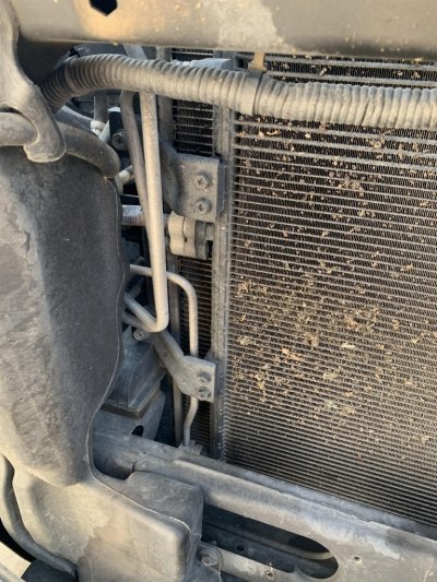

This is what i see on my passenger side of my radiator/condenser. i need to check if the lines are cold/hot when it’s overheating, to determine if i need a trans cooler flush.

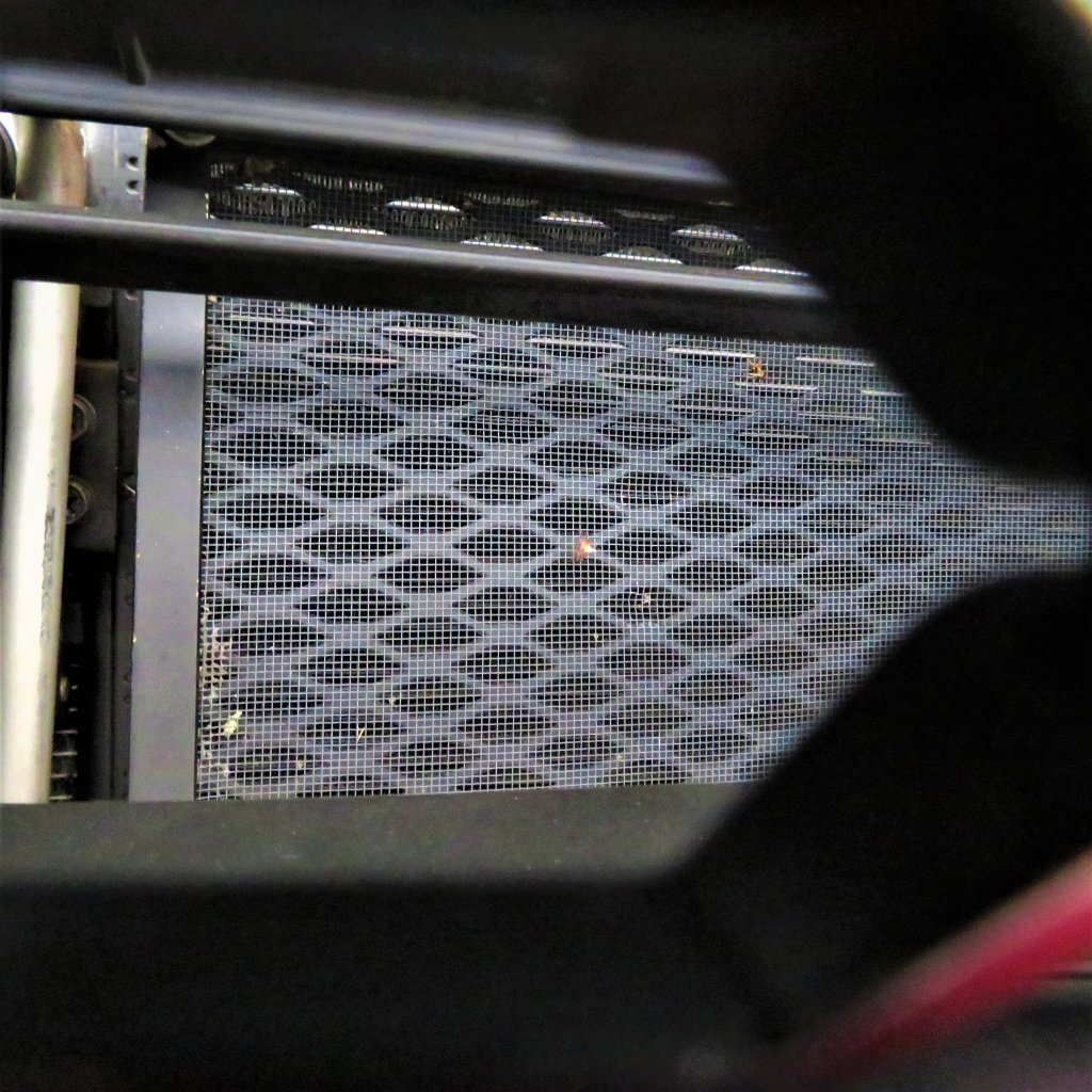

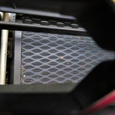

It looks like you don't have the tranny t-stat.The condensor looks like it could stand a blast at the carwash a bit though. You need a bug screen ,lol.****** pic,but you can see my homemade bug screen that bolts in at the bottom and uses factory push pins to hold it at the top

That’s really smart, and yes, i completely agree with it needing a good cleaning LOL. Hasn’t been cleaned in 8 years

It makes a world of differance at keeping the condensor clean as you can see.Not a bug on my condensor,lol. it's been on the truck since it was brand new as i used to build them on the side when i had my old 2013,so it needs a touch of touch-up paint,but my rad/condensor are vitually spotless for a going on 7 year old truck now
