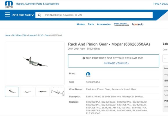

Ken, what is the VIN # of your 2013 RAM?
When you go to the authentic Mopar website, plug in your VIN, then search for Rack and Pinion, what results do you get please? Maybe you are getting the same results of me but you figured out another way to try a different part number. Or perhaps your VIN provided different results.
We both have 2013's but not sure the websites will yield the same results.

Despite the info before, I did find something that supports Ken's part number could work for my Ram indirectly. When I try to put my VIN in and directly put in Ken's part number, Mopar says it will not fit.
However, when I go to Rock Auto, it says Dorman 601-903 is interchangable with R85733449AA AND Ken's Part Number 68628858AA.
This is the closest that I can find. Thanks Ken you are on to something. Appreciate it. What really stinks is that when you go to the Mopar sites and plug in my VIN it says it will not fit. Yet when you go to Rock Auto Part 68628858AA does not show up for 2013 Ram, but when you pull up the Dorman, the Dorman page does say that 68628858AA is an "interchange" part. And from a non-expert look, it looks the same. And guess what the price is not bad too.
So in around about way, Ken's OEM could work for mine. Too bad 68628858AA did not come up with my VIN in the first place. I could have gotten the OEM part from the get go.
This looks Rack parts thing looks like a cluster. Even my dealer doesn't know what OEM fits. Apparently they have not had this problem often even though it seems like to happen nationwise enough.

Hey Ken, that is fine that you don't want to post your VIN. Out of curiosity, would you please go to this authentic Mopar website and plug in your VIN , search for "rack and pinion", what model number comes up? When I do it for my 2013 the R- part shows up. I don't get the 6 part.
Also you said that my original part number started with a "5". You said is "moparpartsonline". would you please post the link for the website? I don't find that as a real website. That would be so helpful if I can see that.

As an update, I contacted Stellantis in Michigan, and after much investigation, Stellantis recommended that part number 68628858AA be installed, the same part that Ken recommended. I did convey the part that Ken recommended at first, but the dealer would not install it because according to the software system, it showed it was incompatible.
So Ken was right and with the help of Ken and Stellantis, we finally go it right. This part was installed and my RAM for the first time in over 3 months finally drove beautifully. Thank you Ken and all on this thread. I really appreciate y'll. I really appreciate the folks who post on these threads. I finally got my wonderful truck back!
