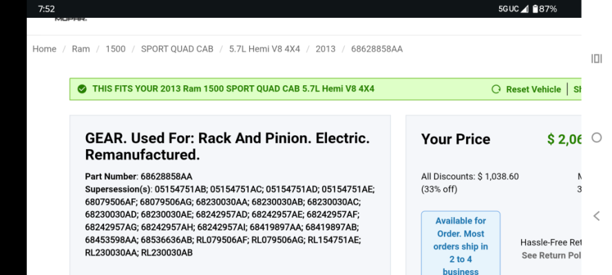

Your dealer doesn't know what they are talking about. Unfortunately, my dealer said the same thing, but I was able to figure it out on my own. Here is my post, from way back then:
I have the same year truck as you, and I can assure you, it's been working perfectly for a year and a half.

Here it is.
As you can see in my post #81, my "dealer" was just as competent as yours.
Then you can fast forward to post# 84 to see what part# fit, and how it worked out in the end.

r8573449aa is the part number for a remanufactured Mopar steering gear. It isn't the original.
See the info i posted in the other thread.

Dorman shows this part for several years including the later models that have "power steering assist".
Same with the Mopar units that actually work right.
I posted more info, as well as a link to this site in the other thread.Screenshot_20250907-075238.Chrome.png
