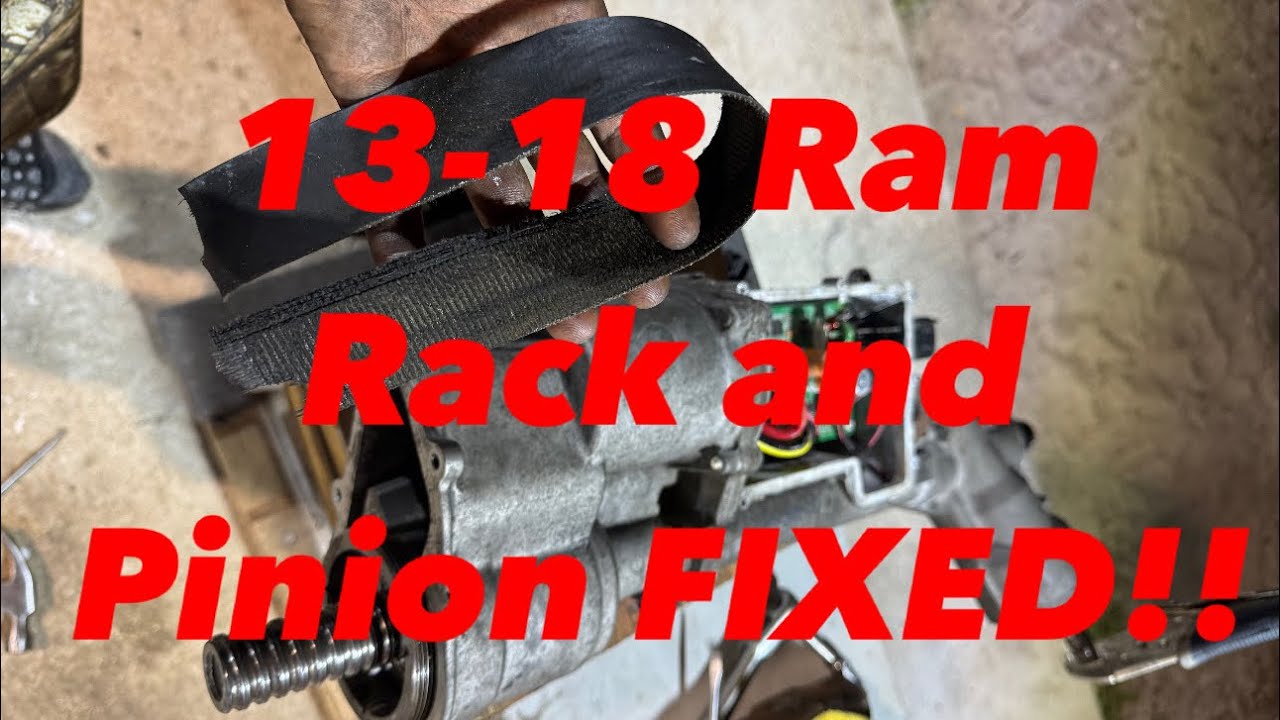

This gives you an idea of how they are constructed and some of the inner-workings ...if it matters to you. And how to change the belt:
