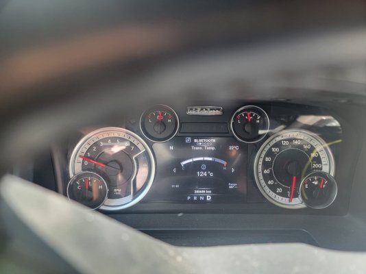

Thanks everyone here - checked and cross checked from two mechanics. They said Thermostat is OK and fluid is ok - according to them 2013 SLT RAM 1500 3.6L Gas works with high temperatures- its ok.
Today, I tried to go offroad and my transmission goes 124 degree Celsius - I found it not normal and decided to quit and come back. There was no warning lights, beeps or anything from machine except temp telling me 124 degree C

124°C is 255°F.
No bueno, IMO. Even for a V6.
Bad trans temp sensor/thermostat? Only use OE if you end up replacing.
Do you have the 8 speed trans? Bad thermal unit?
Definately check trans fluid level.
There has to be a method to test the sensor, which I do not have.
Something definately not right.
