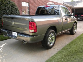

It's weird... did any of you guys who got the chrome clads on your 4th Gens get a rear sway bar in the package too, or is this something new that Ram is doing?
YUP! Have a 2012 Express e/w Hemi, chrome clads, sway bar and traction (long) bars!

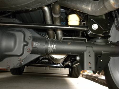

I just looked at my new 2012 Express reg. cab and it looks just like that picture but I don't see a sway bar on my truck or in that picture either. That big horizontal bar looks like a Panhard bar to locate the axle from side-to-side. Maybe I'm confused.

2012 express here to with chrome wheels and no rear bar......

You don't have a rear sway bar. That bar is a panhard bar which is part of the 4 link system that every 4th gen 1500 has

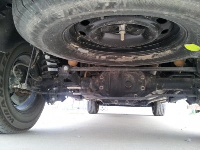

Which is the sway bar? there is a bar above and below my rear end.

The sway bar in that picture is the one that comes straight out from the differential case. It's connected to the frame and the axle.the one closer to the ground if that helps.
