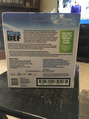

Just bought my first box of DEF @ the local WM.
This box was out of March production of 2018: so I feel confident that there will be no issues. My fingers are always crossed though.
$12
This box put me @ the full mark according to the DEF gauge.
