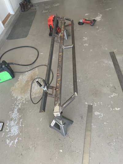

Gasless mig is tougher to learn on,lol.
Hey now. Lol. I believe you are referring to Flux core… the harbor freight special is my friend. Dc flux core welder for all my home projects. May not be the prettiest but it definitely gets the job done. Best part is it’s super adjustable on this one for material thickness and wire speed. Plus it accepts .30 and .35 wire which makes it even more versatile for spot welding thin metal.
I like this little guy,as i've owned one for 20 years,and it's done pretty well everything i've ever needed for my home based needs.By no stretch is it the best,but for my needs it works okay.I have it set up on gas though,you can buy an aluminium spool gun for it,but the spool gun is worth more then the welder,lol.
My next big learning project is going to be aluminum. Plan on making a full belly pan with an integrated drive shaft loop out of aluminum.
