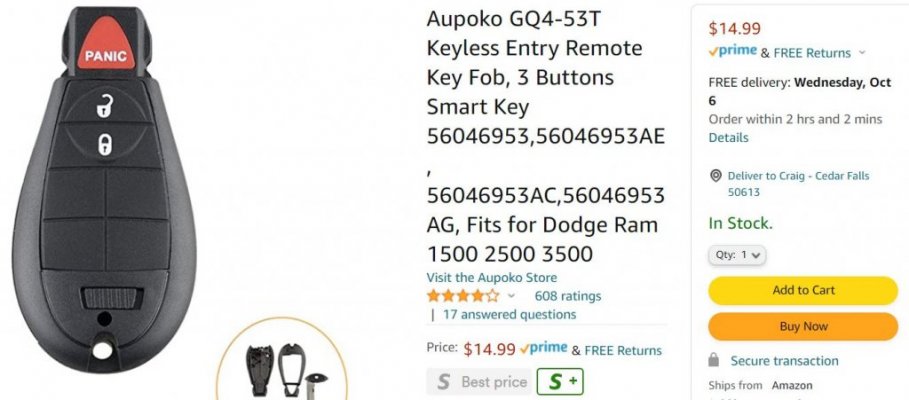

As far as how long it takes, it's a matter of a few seconds. Here are the steps:
I've programmed several of these key fobs for friends that have 2014 Ram 1500 trucks and had very good luck. As shown above, alphaobd not only programs the key fobs, but it also queries the vehicle to find out what the 4-digit PIN is.
