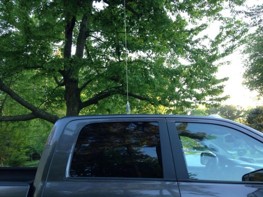

BTW... I don't know what kind of power someone was running to get a magnet mount to discolor the top of that truck but I would have to think it was a crap antenna without a loading coil. I have had some serious amps in my truck in the past and I can pull my magnet mount and there's nothing there.

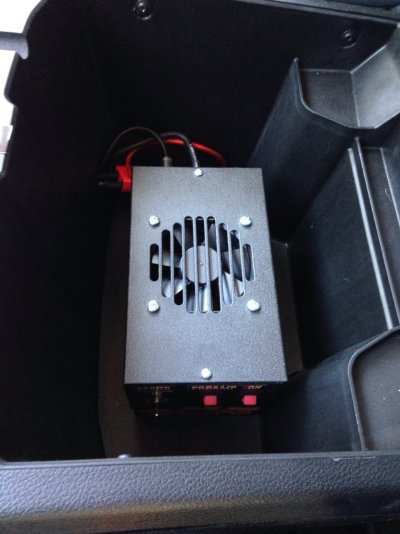

Got my Amp tuned and installed a MFJ/822 Watt/SWR meter inline (center cubby) so I can tune my RF Power to dead key exactly 3 watts before I use the Amp. Radio will dead key about 12 watts with the RF Power turned all the way up and it will kill the Amp if I don't turn it down before I use it. After the Amp tune my input and output SWRs are now flat across the board once again. This thing is booming now.

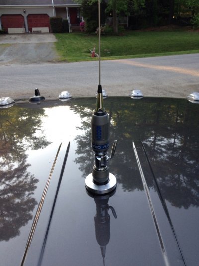

Coax: Times Microwave LMR-240 Ultra Flex
Antenna: Sirio Performer 5000
Antenna Mount: Breedlove
The antenna is foldable. If you go back a few posts you should see a lever on the side. You just twist it and it folds down...or you can unscrew the lever completely and remove the antenna.
I forget how tall the antenna is but it is longer than the Wilson. For some reason 72" is stuck in my mind, but I could be recalling in error. (It blows the Wilson away in terms of performance).

For what you want to do, a good basic radio like the Cobra 25 and a Wilson 1000 mag mount antenna (see my first post in this thread) will be just fine. No amp needed. You will still need to tune the antenna (as you would on any new setup).

You could do that but you will get much better performance with the antenna on the roof. If you don't mount on the roof...the rule of thumb is to have 2/3 of the antenna above your roofline.

Cobra 29 would work just fine. You can still mount a firestick back there, but there will be trade off in performance. The higher you can get the antenna the better.

Read this post with great interest. Funnily enough found it via Google search even though i post in the gen 4 1500 forums often. Wonder if the coax around the back window then through the back sewt grommet into cab will work on a 1500 QC. I've got my cb and mag mount arriving shortly.

Finished pics. Lowering the headliner is not a quick job if you have never done it before. I took my time and it was totally worth it. After lowering the headliner it became clear that there was only one small area between the roof supports to mount the antenna. I was using a mount that had a large surface area to further ensure the roof wouldn't buckle with the weight of the antenna at highway speeds. You've heard the saying that your radio is only as good as your antenna and coax? Well it's true, I'll be damned if my radio isn't louder and clearer.
Antenna Mount: Breedlove SO-239 (#179).
Antenna: Sirio 5000 Performer.
Coax: Times Microwave LMR-240 with heavy duty 3/16" ring lugs.
I haven't even tuned the antenna yet and my SWR is.
Channel 1: basically a flat 1, maybe a hair over.
Channel 20: 1.15
Channel 40: 1.3
