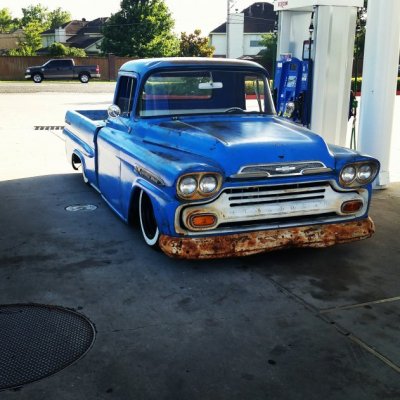

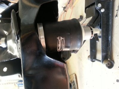

Blacksheep is right. I only got about 5" of lift out of my shockwaves on my 59. It did save me fab time on trying to figure out where to install a shock and fabbing the control arms for other bags.
