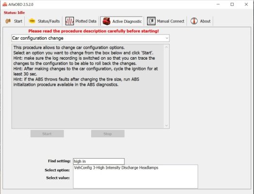

Also, many users with your vintage of Ram truck have experienced intermittent flicker or dropouts.
Given that the earlier trucks suffer from this versus more recent models, I'd blame the trucks, not the LED bulbs. There is a fix.
The AlfaOBD app has successfully cured both intermittent flicker & dropouts by setting the headlights type to "High-Intensity Discharge Headlamps'.
The use of AlfaOBD will require a USB or Bluetooth dongle for the OBD2 port and a Windows computer or Android device.
AlfaOBD is not VIN locked, you can use it on any FCA vehicle.
AlfaOBD also has many other valuable tweaks. :cool:
