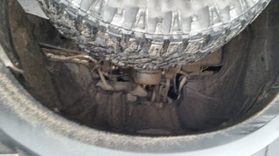

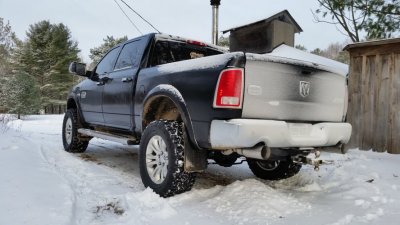

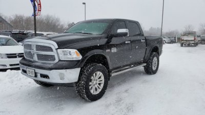

With a body lift you'll need to adjust your exhaust tips. I've attached attached pic of how mine looked before and how they look now with the exhaust raised and added 5" tips.

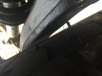

I've also attached a pic showing the front wheel well. That's why you'll want the Gap Guards. Sorry for it being upside down!

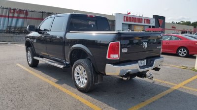

I've got a zone6/5 lift and love it. Got stock 20" rims on it and it's real close to the knuckle
