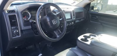

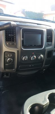

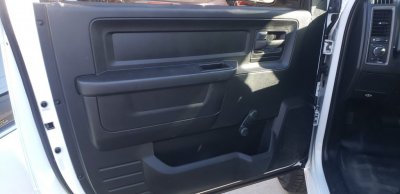

Where would the modules be if they were present? I'm going to take some things apart and see if the wiring for the mirrors/locks/ windows may be there. Seems like there may have been some options that got taken off this truck as my hood had the cut out for the hood light, but no light. Also has the wiring under the dash for the driver and passenger foot lights. There also doesnt seem to be a place for the switch in the door. I'll post some pics of my interior. 20200129_091606.jpg 20200129_091616.jpg 20200129_091606.jpg 20200129_091616.jpg 20200129_091624.jpg

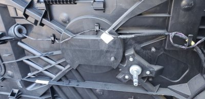

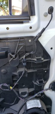

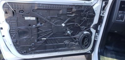

This is what the inside of my door panel looks like, there seems to be wires coming from the mirror in to a connector/harness. And some wires going in to the door where the window is(3rd pic)

That indent just to the right of the bit of yellow tape on the wires is where the module would be.

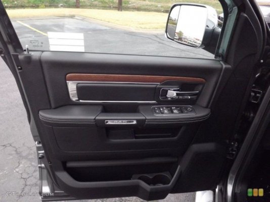

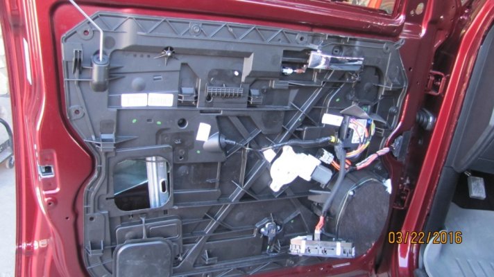

Here's a picture of the inside of the door on a truck equipped with all the power bits. While this might be a possible conversion, you're going to require new door harnesses and probably new door panels (the armrest on the power equipped trucks comes forward all the way under the handle, which is where the switch mounts.) It will, in other words, be a lot of work and expense. If you can find the parts at a salvage yard, it might be practical.
