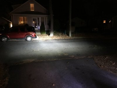

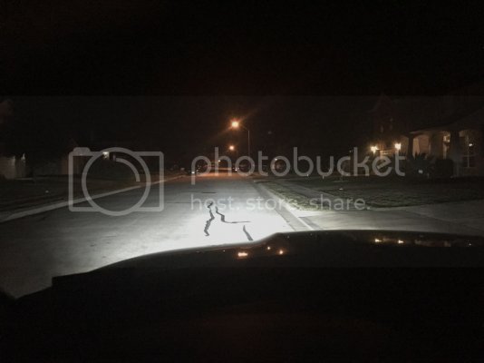

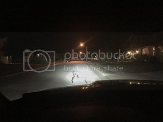

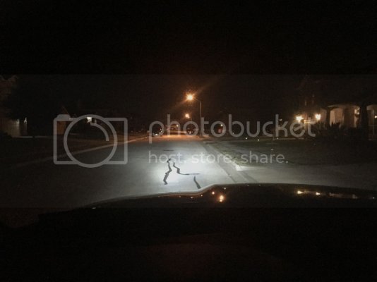

To follow up, here's a few a pics. Have experienced ZERO problems with the lights since installing the decoders from Auto LED Corp.
Low Beams
Low Beams + Fogs
High Beams

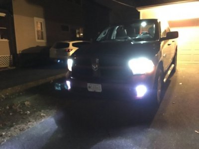

Low and fog. Have the high led's but didn't install yet.
