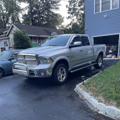

I have similar question. I currently have the tow mirrors on my 17 Laramie, but i don’t like them. I want same futures i have now on a smaller mirror with power folding.

The ones on the truck now are chrome, so i prefer that or color matched if they are cheaper. Truck is silver! And the truck don’t have power folding mirrors

Ok here are your options
Chrome Mirrors
Painted Silver
You would then need to add the following parts as well
Ill send you a code you can use should you decide to order them.
