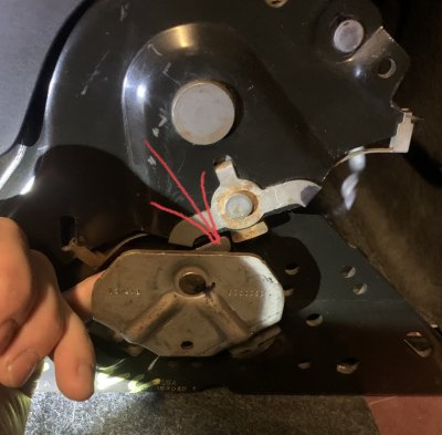

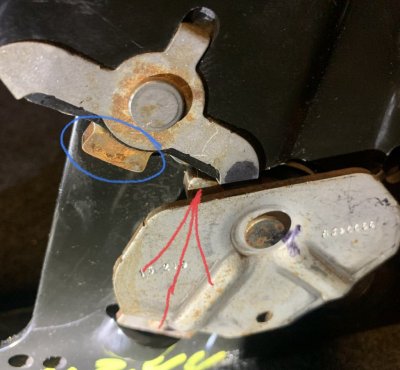

I have a 40/60 split bench in the back of my truck and had the same issue for a while just on one side. I found that there is a sort of spring loaded catch in the actual seat hinge that I am assuming will keep the seat from flipping closed or open in the event of an accident. But I had found that the hinge had gotten gummed up and would not allow the swinging hammer catch to return to the neutral position. I had to clean it in place and lubricate the hinge really good to get it to stop catching.. I will try to take a picture of it and show you what was causing my to hang up.
Kurt B
Oct 3, 2020
18
Hillsboro Mo
The red arrow is pointing towards the actual swing that will catch on the nub that is circled in blue in the event of a sudden quick movement of the seat. In a normal operations when you are moving the seat up or down the floating part in the middle(red arrows in both pictures) will hang flat and miss the catch/ nub circled in Blue. Mine was all clogged up with dirt keeping the floating part from returning to neutral level hanging position which would allow the seat to flip up or down..Again I believe it is a safety issue in the event of an accident to keep the seat from flopping up and down. Make sure that swinging level catch is able to swing freely . If it is getting hung up then you will have the above mentioned issue. Once I cleaned mine out and oiled it up real good the seat started working smooth again.. Good luck..upload_2020-10-14_8-53-6.jpeg
