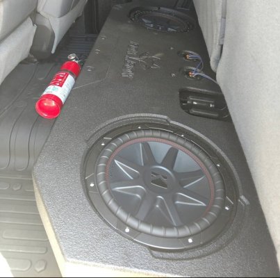

Looking at picking up a Fox Acoustic dual 12" vented under seat enclosure for the '17 2500 crew cab, but I ran the air lines for the aftermarket air suspension through the back cab wall at floor level.
With 90* bulkhead fittings, I only need 1" of space off the back wall to clear, but since Fox has provided zero dimension information on their site, and absolutely lousy photos, I can't tell how far back it's going to sit (though admittedly, there's probably not many people that would be in this situation either)
Anyone with one of these boxes able to measure and give me an idea?

Where in AZ are you? I am in Chandler. I have a Fox Acoustic 2x12 vented just collecting dust in the garage. Exactly what you are looking for.
There is about 4in to the back firewall with the box installed. My amps were mounted on the rear firewall between the box and the rear firewall.
If you want to make sure it fits, swing by and try it out. I just don't have any of the .750" (3/4") seat spacers left. Had to let those go with my old truck when it was totaled last year.

Where is AZ are you? I am in SW Chandler. I have a Fox Acoustic 2x12 vented just collecting dust in the garage. Exactly what you are looking for.
I'm out in Methmann..uhh, I mean Wittmann:anitoof:, so a little over an hour from Chandler.
4 inches is plenty of room. My air fittings stick out a hair less than 7/8" from the panel, and are 90 degree elbows, so the lines won't come out any farther until the next turn at the seat brackets.
Seat risers are simple to fabricate, not even worried about those. I was already planning on that anyways as I had read a number of reports that the 1.25" spacers included with the box really weren't enough for most subs. Seems many guys were replacing them with the 2.5" spacers.
