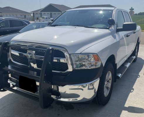

Hello,
I recently purchased a 2016 Ram 1500 SSV (special service vehicle). I really am enjoying this truck. There are some things I’m wondering if someone can help me figure out… 1) how to re-enable the rear doors so they unlock and passengers can get out without help from the outside (was a police truck). 2) how to re-enable the interior lights to come on when door is opened. Currently has a dome light with a 2 directional switch (red/white). Any other advice or how tos are also appreciated!
thanks in advance!
