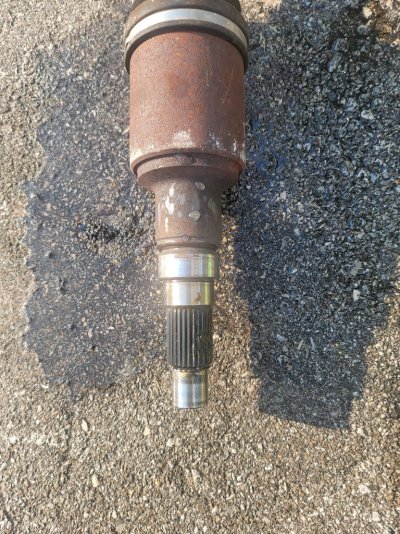

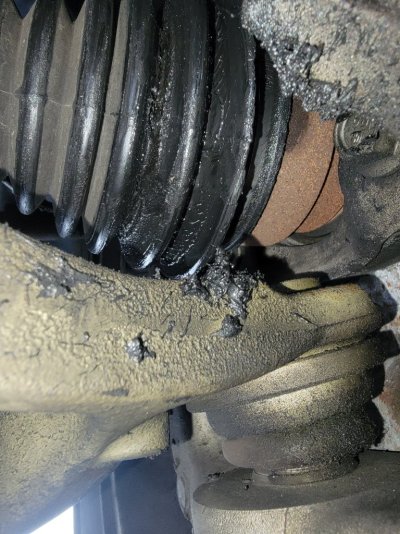

Hey all,
Got up this morning and decided to check out the undercarriage on my 2016 RAM 1500 (5.7L, no air ride). I noticed that the passenger side CV axle is pulling away from the intermediate shaft, and I can see some wear/stripping on the shaft ends.
Looks like I'll need to replace both the intermediate shaft and the CV axle on that side. I'm reaching out to see if anyone has recommendations on quality brands for these parts that won’t break the bank. I’ve seen a full set going for around $2,200—which is way out of my budget.
Has anyone replaced theirs and been happy with a specific brand? I’m looking for something reliable, but not top-dollar.
Appreciate any advice!
Thanks,
Tim

Has anyone ever replaced the cv axle? are you orig owner? Its possible the clip rotted away or someone never put it back to begin with. I can see ont he shaft its self it still has a ridge for the clip not sure why wou would need to replace the shaft its self I would try a new clip frist and inspect the cv axle.

Yes, I’m the original owner—Purchased it new off the lot in 2016. I've never had any work done on the front CV axles.
I’ll go ahead and order the clips and let you know how it turns out. The CV axle appears to be in good condition—no leaking, and the splines don’t seem stripped—so if the clips fix it, that would save me a ton of $$. The OD just turned 61k miles so not a lot of mile on it. Really appreciate the help! And will let you know the outcome.

Dumb question for the day (because there’s always at least one, right?) — once I get the new clips from Amazon, how exactly do I install them onto the shaft? Is it a C-clip that snaps into a groove, or do I just tap it on with a socket and mallet?
Trying not to butcher anything this time
Also, just to be safe (and because I like to be prepared if it all goes to ****), I ordered the following backup parts:
  • 2X Cardone New CV Drive Axles for 2012–2020 1500, 2019–2020 1500 Classic
    Part #: 66-3740HD | AAZ-663740HD
  • Dorman Axle Shaft for 2012–2020 1500, 2019–2021 1500 Classic
    Part #: 630-446 | RNB-630-446
Anything eles I should get just incase?

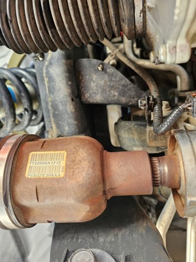

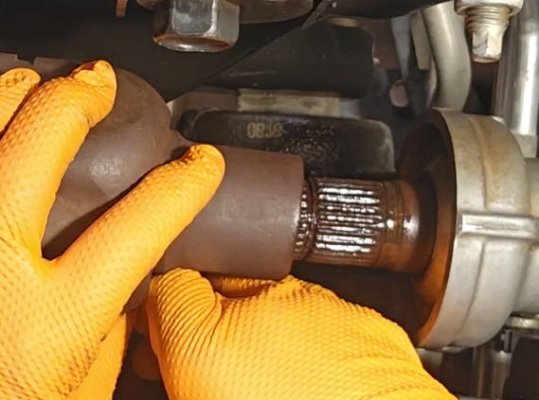

Quick update from this morning — I got a better look at the passenger-side CV axle, and it appears the retaining clip is no longer in place. I've also attached a short video to show the amount of play I’m seeing on that side.
Do you think a new retaining clip will be enough to resolve this issue, or will I likely need to replace the CV axle and clip together?
Appreciate the insight.
Also just wanted to mention — the truck drives perfectly fine with no shaking or unusual vibrations. The only reason I noticed the issue was because I was doing my yearly undercarriage cleaning and power washing. That’s when I saw the CV axle wasn’t fully seated and started investigating further.

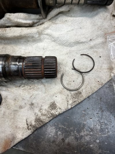

I've had to replace mine twice because of the rubber boot was lose and slinging grease everywhere on the wheel side. 2010 Ram 1500.

I just did this to my 16 eco.
There is a great kit for the inner shafts on Amazon
You tube has videos
You will also need clips as the ones with the kit would not work for me.
The front dif does not need to be taken out only the right end comes off.

Watching that video, the stub shaft has had a problem W the spline wearing out causing all of that play in the CV shaft ( or axle shaft) so the stub shaft Assy has to be removed from the differential housing, I've rebuild a couple of the units from these guys that sell a rebuild kit, if nothing else watch there video.

I replaced both shafts and both cv shafts. The spline was worn wobbly bad on the right and stuck on the left. I used the inner clip from the left one over on the new short inner shaft.
Also take a look at your front driveshaft U joint.
I had a new one installed by a driveshaft builder. It even now has a grease fitting.

✅ Job Complete – Front End Overhaul Recap
After roughly 8 hours total, the job is finally done! All new parts have been installed, and the truck’s front end is feeling solid again. Big shoutout to DILLIGAF for recommending the SuspensionMAXX Sway Bar End Links – super helpful and a great upgrade.
️ The Job:
Honestly, not too bad. I had the time and wasn’t in a rush – helps having three other vehicles in rotation. It goes in for an alignment this week (just to be safe), and I’m also getting a set of Fuel Slayer 20x9 +1 offset wheels installed later this week.
________________________________________
Things I’d Do Differently Next Time:
• Wait until ALL parts arrive before starting. The waiting game sucked.
• Press the bearings on the intermediate shaft before even starting the teardown. Spent over 2 hours just finding a shop willing to do it ($25 well spent).
• Print out torque specs and keep them nearby for easy reference.
• Have the right tools on hand. Tools I had to hunt for:
o Torque wrench rated to 185 ft-lbs
o Snap ring pliers
o Pry bar set
o 35mm 12-point socket
Parts I Wish I Had Done (Next Round ):
• TTX Wheel Bearing & Hub Assembly – TXF25309
• TTX Control Arm + Ball Joint (Left) – CTXMS25149
• TTX Control Arm + Ball Joint (Right) – CTXMS25150
Final Thoughts:
• PITA? Yeah, at times.
• Difficult? Not really.
• Time-Consuming? Absolutely, especially first time around.
Most of the frustration came from not having the right tools ready and not having some tasks (like bearing pressing) knocked out ahead of time.

I guess the way I was looking at it was — I didn’t really want to do the work, but I also didn’t want to pay someone else to do it. And I definitely didn’t want anything falling apart on the trails in Ouray. So if I was going to tackle it, I figured I’d take care of as much as possible while it was already out of commission.
The lower ball joints had a bit of wiggle — not terrible — probably could’ve gone another 20k miles (just a guess), but figured I might as well replace them now.
As for the passenger side shaft, it was pretty hammered. I don’t think just putting a new clip in would’ve held for long. The splines on both the shaft and CV axle were noticeably worn.
I did hang on to the driver’s side CV axle — it was still in good condition, so I kept it as a backup.
For reference, I’m running a leveling kit: 6112s set at 2.4" up front, with Icon 1.5” lift rear springs and 5160s in the rear.
