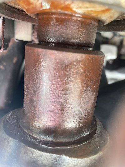

I’ve got the entire front suspension pulled apart because I’m going to replace everything. 160,000 miles
I got the driver side CV axle out quite easy. I watched a bunch of videos on YouTube. It came out with that short intermediate shaft. I wrapped a towel around that and put it in the bench vise and it came right out.
I’ve been struggling for two hours on the right side (passenger side). I watched a video of a guy up in Canada hitting it with a large hammer. Also with punches. It only came loose when he hit it with his air tool air hammer.
I’ve had an Ingersoll rand air gun, and a kit in my toolbox for a few years. I broke it out today and hooked it up to my compressor. I can’t get this cv axle loose. It might’ve moved 1/32 of an inch.
I even hit it briefly with some map gas. I sprayed it with PB blaster, hoping something would get in there. I’m running out of options here.
Unless I keep spraying it and let it sit overnight? And try again tomorrow?
What have you fellas used in situations like this?

I found this video late today. After quitting:
This may be my only option to get this thing out. And that’s removing the housing on the inside. I put brand new front differential fluid in this thing that I haven’t driven it. So I have to drain it into a clean container. And reuse it later.
Have any of you guys tried this method in the video?

Heat it with a cutting torch,then beat it loose. Map gas isn't gonna get it hot enough

Sometimes it helps to rotate the axle so that the clip falls into a different place. Push it back in and rotate it 180 degrees. I'm assuming we are looking at the axle at the transmission.

I have had to cut the axle with a grinder and split it apart to get it off only had to do this twice.. You will need a new clip and BE CAREFUL not to damage the splines or youl be replacing the shaft to.

I was contemplating that. But didn’t feel comfortable trying it. I have a 4” makita grinder. Too big and wound probably hit the housing on the intermediate shaft (passenger side). Unless there some type of “mini grinder” to cut metal.
Going to try this method. Going to soak in pb blaster overnight. Will replace the circlip and o ring.

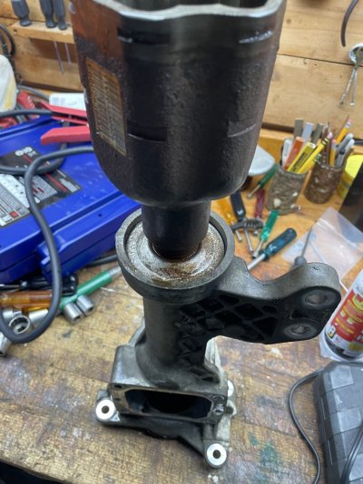

I found a YouTube video yesterday. I removed the CV axle from the back metal housing.
I don’t know what the correct name for it is, but I removed that intermediate shaft housing on the passenger side. Six bolts. I had to wiggle it out and tap it with a hammer a few times.
I’ve got it on the workbench soaking with PB blaster. I’m gonna let it soak overnight. Then tap out that back housing of the CV axle.
I have to order a new CV axles along with a few other things.
As I mentioned before with the Eibach Pro lift springs the front of the truck will be about 2 1/2” higher. Can you guys recommend some really good CV axles? I’d like to get it ordered today.
