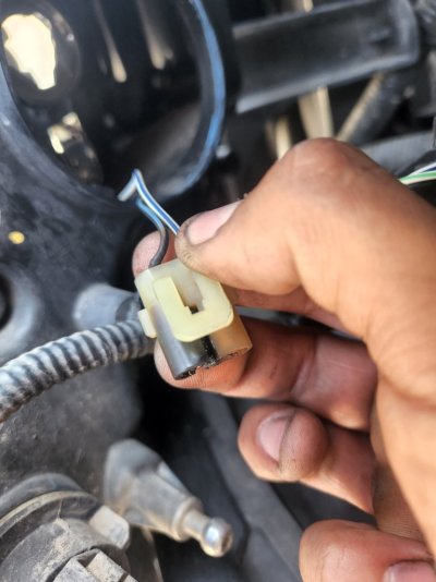

2016 RAM 1500 headlight went out
Jacinto
Nov 16, 2022
SoCal
Pentastar V.6
What's up everyone, would yall recommend splicing the headlight socket? Driver side light bulb has burnt out for the second time already and Im 100% this is the reason why. Or can I just replace the headlight harness? I've watched a couple videos and I wanna know if anyone has had the same issue and what you did to fix it! Thanks in advance. 584.jpg

Sure, I’d get a new replacement socket and splice it by soldering the pigtail…not crimp-connectors. I’d also use some di-electric grease in the socket to prevent that from reoccurring.

Replace, but use waterproof splices, or solder and heat shrink.
