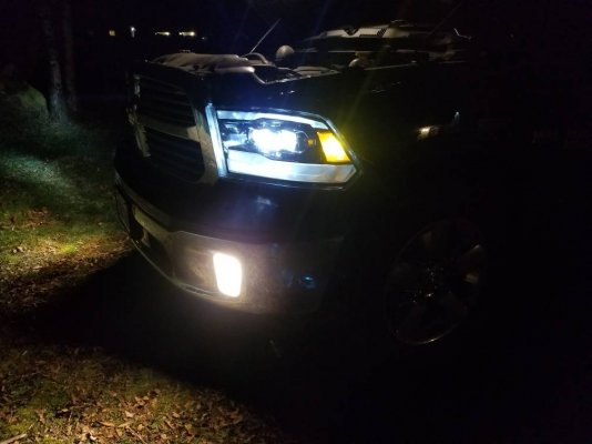

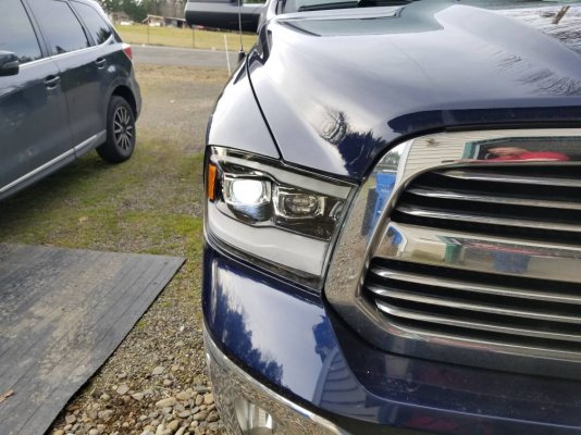

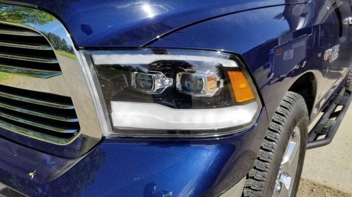

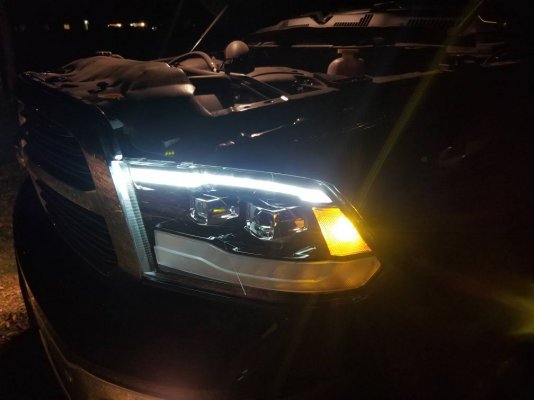

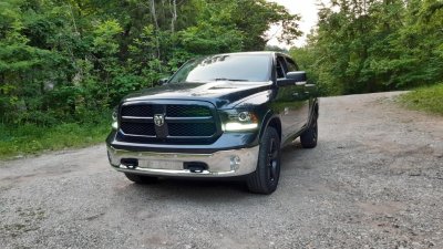

This is the exact kit I bought, but I recommend getting one without HIDs and sourcing your own light bulbs if you want something other than the included H7 Halogens:
https://www.amazon.com/gp/product/B07NPZS2MJ/ref=ppx_yo_dt_b_search_asin_title?ie=UTF8&psc=1
I have already replaced the HID bulbs (kept the ballasts from this kit) for ones that are 4500K 55w.
6000K is not the best for vision...4300-5000K is.
6000K LOOKS better for aesthetics, bust is less visible light for your eye. The higher the temperature color, the less light you can actually see. I live on windy, hilly country roads, no lights other than me, lots of critters ranging from mice all the way up to bear (very rare)....I prefer to see them and be able to avoid them.
