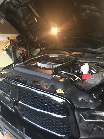

Got this good and took the inside cover off that directs the air to a typical K&n cold air intake ... So now it goes directly to the engine bay where it meets my vararam. Hoping to see some Gains once I get my long tubes installed and have Hemifever read my log and tune it ! What do u guys think??
that hood is bad ass, where did you get it
