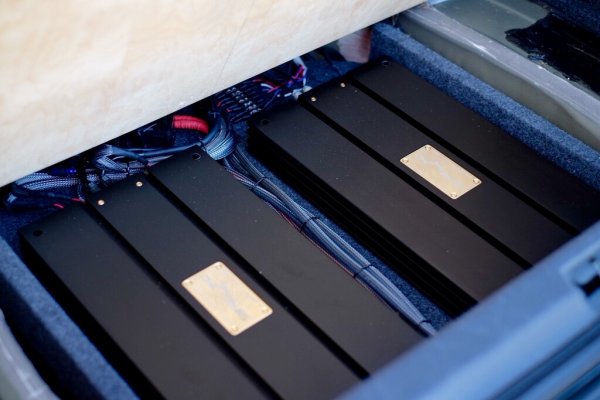

These are the amps that were just removed from the SQ car.67e54400b3fc1fed0435125ae05db91b.jpg

Darkness....good looking Brax amps sir!

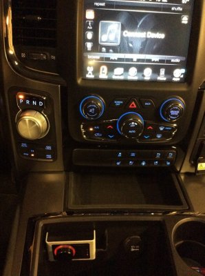

Hey adrian89.....I agree with you on 90% of what you say except for gutting everything. I left the head unit and factory amp in. (8.4nav with alpine). It's only used to send the high level signal into the processor. Wanted to keep dash looking factory. SQ is amazing.
adrianp89
Sep 3, 2015
3,176
1,276
Tampa Bay, FL
With the new PAC interface life is much easier to keep the HU. I would be willing to bet you forgo the processing and use the processor as your volume control?
Eestee70
Jan 2, 2017
423
190
Chicago
What's not shown is the Mosconi 6to8 v8 processor mounted underneath. High levels into the processor and 7 channels out to the amps. No interface ....plus I think the PAC piece only has 6 channels of output. 3way active up front, sub and rear speakers deleted.
