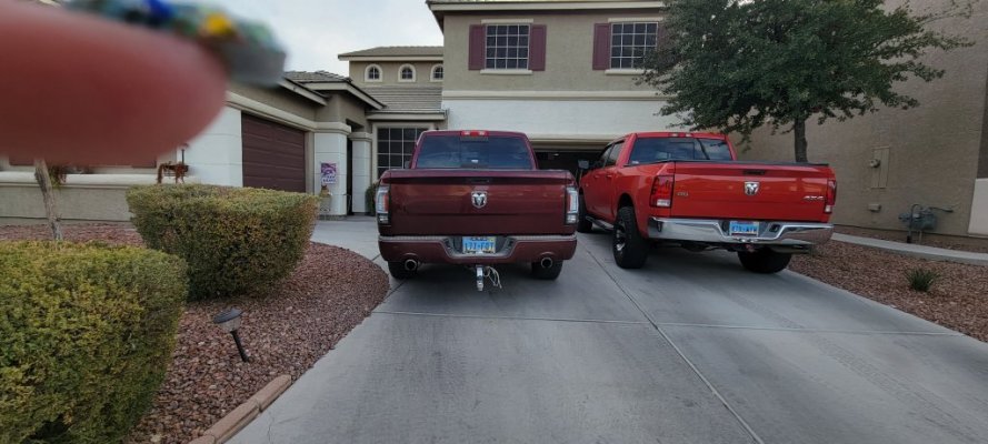

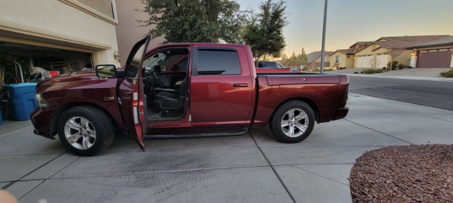

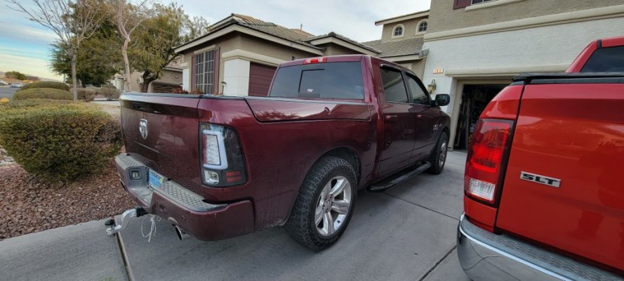

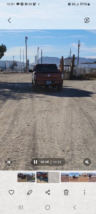

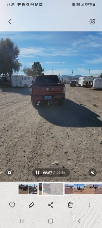

I have a 17 ram sport 1500 the air suspension self leveling has been doing this strange issue for months. When it's on parked on a slope maybe 2 inch grade with force going downhill to drivers side. Car is parked off and I come back to drive the passenger side is in normal ride height and the drivers is in lowest Mode exit entry. When you drive off out my driveway which the slope isn't that bad the car bottoms out on back drivers side u feel it hit like medal to medal big thump. My driveway is flat to road no curb or major drop off the passenger u don't. U almost feel like your going to roll out of seat. U drive down street feeling crooked and then finally it self levels but it takes at least 2 to 3 min to get not normal ride mode driving. If u sit in your car it won't fix it self u have to start moving or hit buttons to go up to off road cause car starts off in normal mode not entry exit. I have pics of it crooked video driving from behind looks crooked. But it's been to dealership twice and they can't recreate the problem. U can see the distance above tire is low and other side is higher it's 4 inches difference
