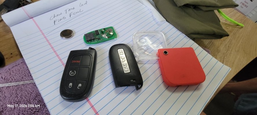

North Coast key in doing a search for key fob after doing the year, model, etcwas asking for the FCC Id number.. on the drop down box it showed GQ44-53T or a GQ4-54T.
I took the fob apart and for the life of me not able to see the number. anyone have to do this before on the 2017 3500 non air suspension laramie and where do you find it??

Found it. Sumbouch. This gq4 54t seem to be the most popular. Ohwell
