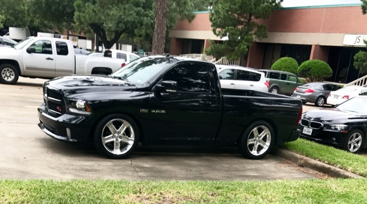

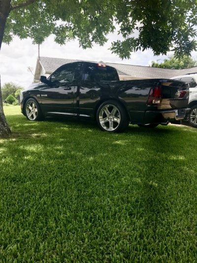

Illicit brackets fixed all my issues..recentered the wheels..corrected driveshaft angle. started with a belltech 2/4..cut coil in rear, removed bump stop cup, helper bags, hellwig sway..adjustable pan...f 150 end links up front..305/40/22 aligned just fine for me.7ceaf56c9c4e2d23c96e60371d21450f.jpgc47091e2dffe1b0a8295a351537aa81d.jpg

Nice drop.

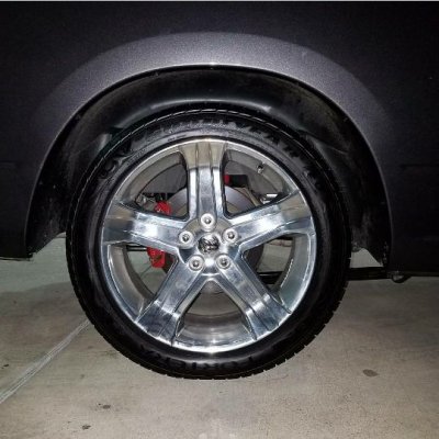

You think you can post a pic of the rear wheel centered in the wheel well?

This is first night we got it all done, I can get some updated pics this afternoonb064b7faa450a320a600d3888bf4f1d3.jpg00a6d38411b8ef76597e5d2693b11abd.jpg

That looks pretty centered to me..
Did the Brackets leave your pinion angle back at 0 degrees?
So since you cut the rear coils, you got a 2/5 drop on the truck?

Yessir about 5..basically that one coil got rid of the rake so sits level, and not sure if it's exactly 0 but it's gotta be pretty close..truck rides night and day differnce..no more wheel hop when burning out. Also launches better/ hooks better from a dig. I did the no cut kit b.c I won't go much lower, but the weld kit guys are running up to 8 inch drop in the rear.

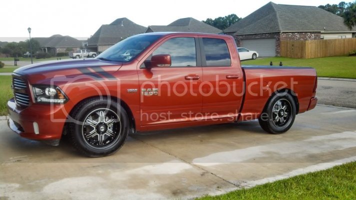

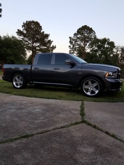

I had the McGaughy 2/4 drop on my 2013 model. On my 2015 I went with the Inez Hotrods kit. Got to say my 2015 rides a whole lot smoother than with my 2013 did and I went lower on my 2015.
This is my 2013 with the McGaughy​ 2/4 deluxe kit modified to a 3/5. Was also running the spohn bars to recenter everything. Sitting on aftermarket rims and stock tires.
This is my 2015 Ram with the Inez Hotrod drop modded to a 4/5 drop sitting on smaller tires. Rides much smoother and I'm going to eventually go down in the rear a little bit more.

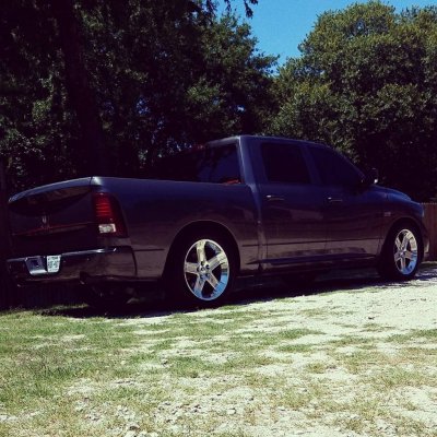

Here is my 2017 lowered on the Inez 4/6 lowering kit3e5576e823a0b62d43cacdc27c974734.jpg
Hardly noticed the truck past that beautiful yard! My wife would kill me if I parked on my grass haha
In all seriousness... super nice truck man!
