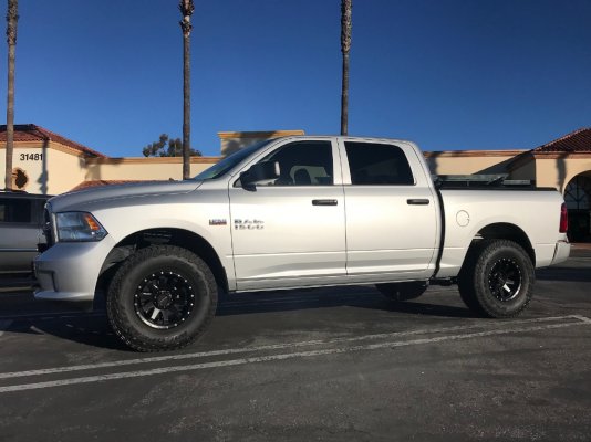

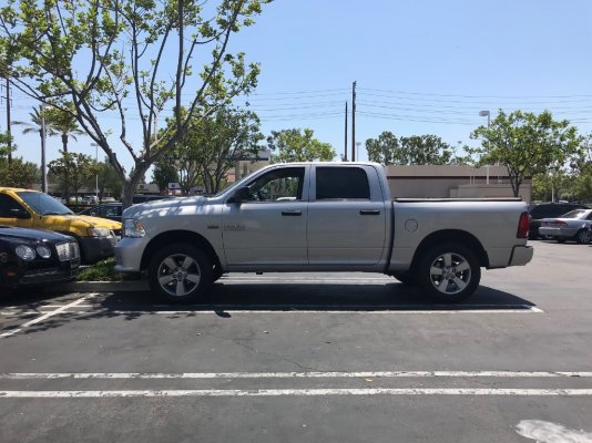

This was stock
43100754435_2c8f773938_h.jpg2018-08-12_08-53-23 by RAM RSM, on Flickr

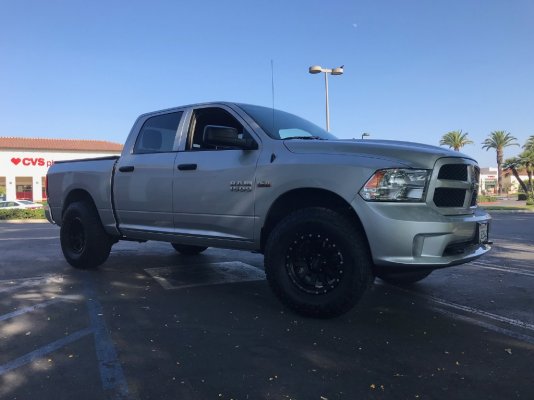

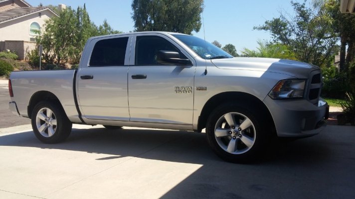

Ranchos and stock wheels/tires
44021207451_672cc27bec_h.jpgUntitled by RAM RSM, on Flickr

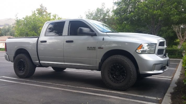

Ranchos and 17" wheels/tires
42334322310_d0c0da81ed_h.jpgUntitled by RAM RSM, on Flickr
Ranchos/Icon Springs/17" wheels/tires
45118463242_c35d2e9818_h.jpg20181007_145507 by RAM RSM, on Flickr
Kings/rear Icon springs/17" wheel/tires
45615442745_6791491c60_h.jpgUntitled by RAM RSM, on Flickr
