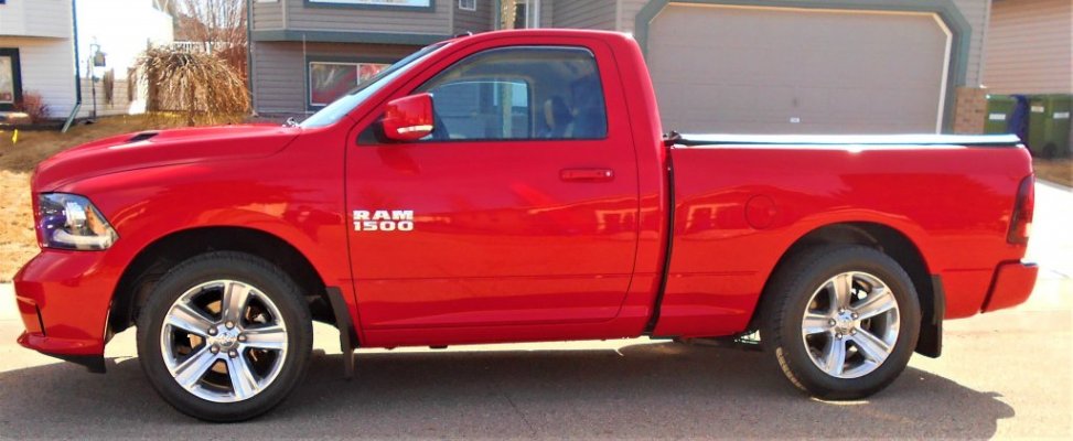

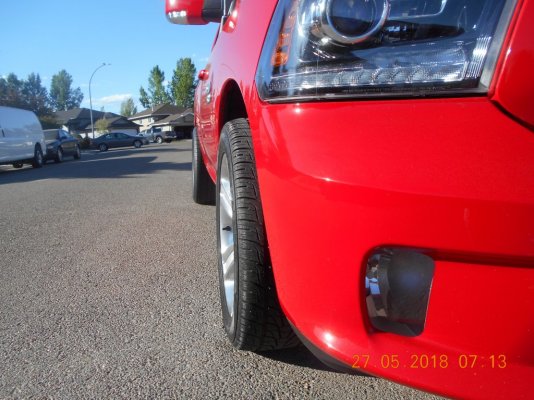

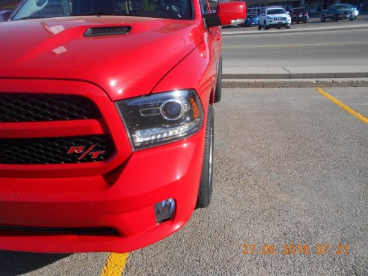

2 wheel drive 2" drop spindles bolt onto a 4X4 and allow you to keep everything factory on the front.They do move the front wheels out roughly 3/8" on each side,just throwing that idea at you. My 4X4 is dropped using 2 wheel drive drop spindles that have been narrowed 0.60" per side,and cut down factory R/T springs on the rear.Ignore the grill,i didn't like the factory Sport grill,so it's had a grill swap.

Oof, that's a great looking truck
