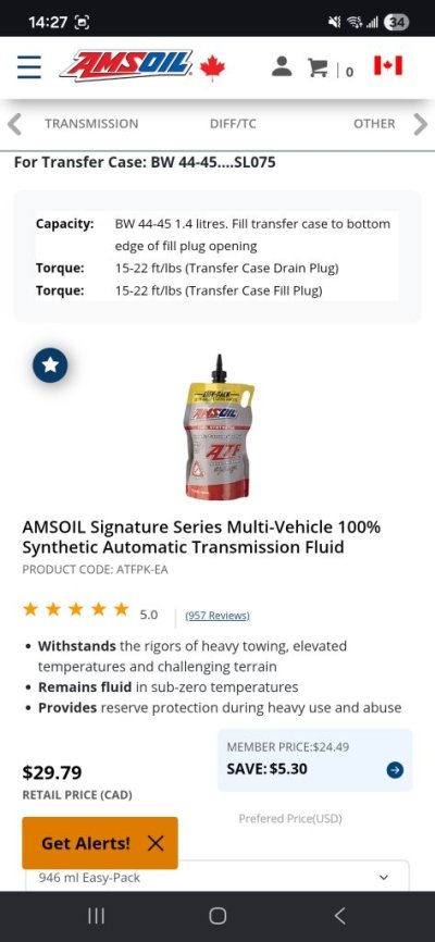

I just did the front /rear axle and transfer case on my 2017. Just go to the amsoil site and search your vehicle. Doesn't get any easier.
Gero
Apr 22, 2018
635
749
Ontario
That is unless you have a BW 44-44 or 44-45 transfer case then Amsoil does not have a recommended fluid to use
I use amsoil for my 44-45.

He'll have the 44-44 transfer case,so not quite the same as you guys with the 44-45.
If Amsoil has a fluid for the 2017 44-44 post up a link you guys touting it.

The same amsoil atf works for both 44-44 and 44-45. Just enter your truck details and thr compatible fluid will be there.
Amsoil does not have a recommendation for the BW 44-45 or 44-44 transfer case fluid for my 2022, they do have one for the BW 44-46 to BW 44-49 but nothing for the 44-44 and 44-45 used in the 2022, 2500 HD trucks. FYI I just looked again to be sure, what model year does your photo cover?

2017 is our model year. Ive used it for my friends 2019 too.

Amsoil must have a reason to not list any of their products for usage in the 2022 BW 44-44 an 44-45
I think there was an internal mechanical of the 45 that added clutches somewhere around 2016. Before that, they were both Dexron or ATF+4 for MOPAR applications. The high priced unicorn pi$$ is for the 44 and the one bottle is for KISS so the parts guys won’t make a mistake and hand out the wrong fluid to kill the 44. It is overkill for the 45 but is just like having gear oil with friction modifier in an open differential. It’s not needed, but won’t hurt it
