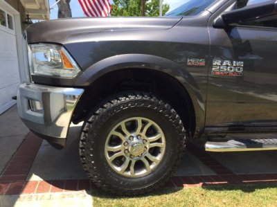

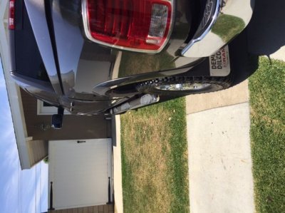

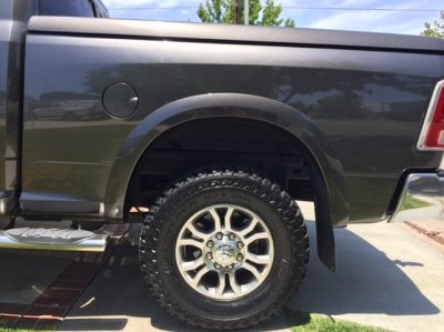

I have new ST Maxx 295/70/18 on my 2500 MC and they look great. Would think 35" would work too but I only have 8" wheels and wanted to leave some additional room so I can run snow chains if needed. I have no rubbage at all.

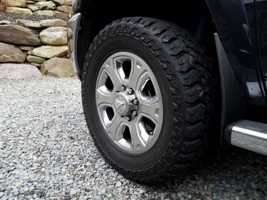

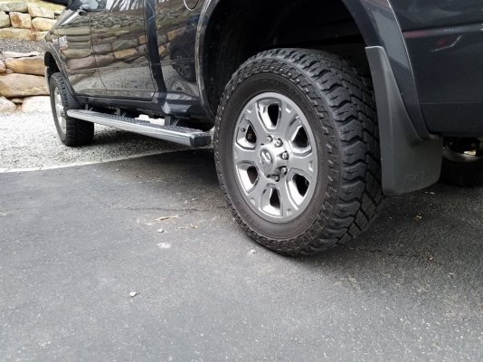

I'm running a Cooper STMaxx 35x10.5r20 on my truck now. No rubbing at all with the stock rims. It's listed for a 8.5" minimum rim but I haven't had any issues to date. I'm guessing my Photobucket pics won't work on a 3rd party site anymore but just in case.

Not exactly, but does this help.
