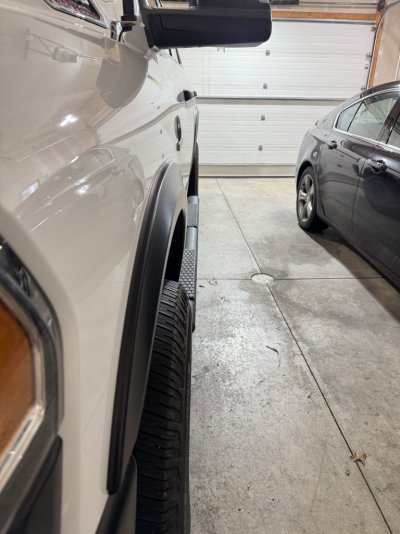

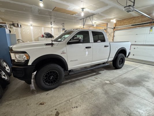

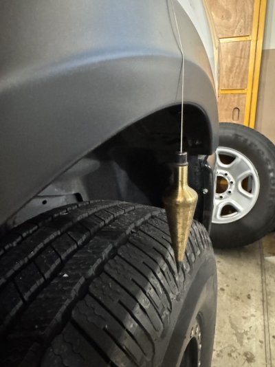

I installed a Michelin Defender LTX MS2
LT295/70R18
Service Description: 129/126S
Load Range: E
Method wheel:
305-HD NV
9”x18” +18 offset
Back space 5.75”
4500 lb.
This combination fit almost flush with the fenders. I then installed a set of fender flares.
Hope this helps, Jerry
