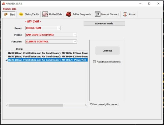

Thanks for the reply I have Alfaodb would that suffice for diagnostics?
I have no experience using AlfaOBD for this purpose, but AFAIK, it is very capable for this type of diagnostics.
Fast69Mopar would have the practical experience to guide you further on troubleshooting.
I have not used AlfaOBD in any capacity. I have a couple of scan tools that I own to be able to perform diagnostics. If you have Alfa along with an OBD dongle then I'd say give it a shot. Do not perform the actuator calibration until you record the data for the doors. If you calibrate first then you won't know what the doors were doing before the calibration.
First thing I would do is go to the data stream for the HVAC control head and look at the data for the mode door and blend door and recirc. door. Using the knob on the control head, turn the knob to full cold and record the data for the doors. You should see a voltage for each door and a percentage or a number represented in degrees for the sweep of each door.
Then, rotate the knob to full hot and record the data again.
Next, perform the actuator calibration. Clear any DTC's that were set during the process and cycle the key afterwards.
Then go back to the HVAC control head data stream and record the data again at the full cold position and the full hot position.
Now you can compare the data to see if something changed during the calibration process.
If you have a door that sweeps further than the full cold or hot position you can end up with broken doors and bushings. When you remove the actuators you can see what they attach to to make the doors move. Hopefully this will get you started and on a path to determine the problem.
