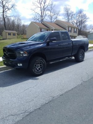

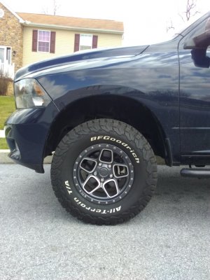

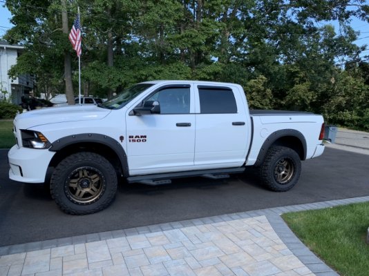

I’d stick with 2.1” for the ride, the tire size you are thinkin about, and keeping a little rake ... Here’s mine at 2.1 with 285/60R20

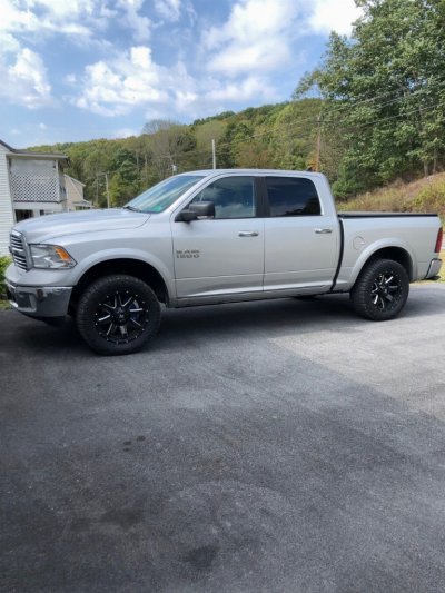

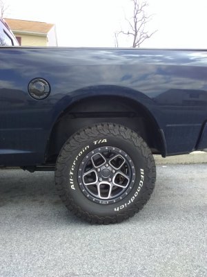

Never went 2.8, here’s mine @2.1” with what you’ve listed above:
Bils @ 2.1”, 1” rear spacer and 285/65/20’s and factory 20x9’s
not the greatest pics, there are a few more in my photo gallery.

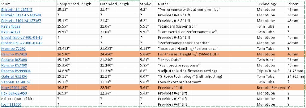

My question - if I could risk sidetracking you all for a bit - is if the 2.1" or 2.8" doesn't make him(a RAM owner) happy, what is considered the next step up in level/lift in terms of practicality? What would you suggest if not the very common Bilstein/Mevo/Rear Spacer combo?
On the front suspension of 4th gen, 4wd Ram 1500's the total suspension travel is limited by the strut itself - so longer strut assemblies equal longer extension. The strut's mounting position on the lower control arm is approximately 2/3 the distance from the chassis to the ball joint so wheel travel is approximately 150% of strut travel.
Here are the actual lengths of common struts:
The part I'd like to draw your attention to is that the Bilstein lift struts we're talking about here are actually shorter at full extension than Monroe OE replacement struts and generally their difference in length is inconsequential when compared with other stock replacement shocks.
When you lift your front suspension with any of the multi-position lift/leveling struts you are just trading down travel for static ride height and eventually the loss of down travel begins to affect how the truck handles over bumps.
