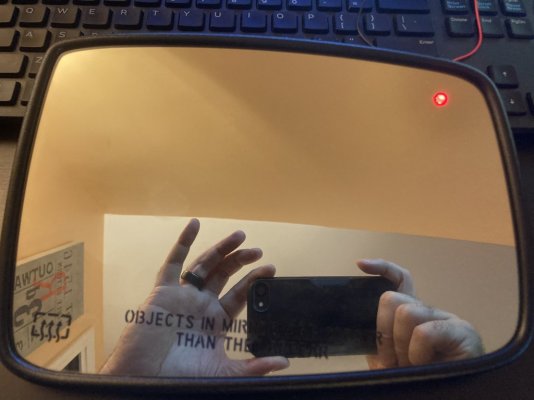

I would like to do this mod on my ‘19 Classic with sport mirrors at some point. As far as I know, they don’t make the glass with the BSM light for sport mirrors. Well I had an extra piece laying around from a mirror I needed parts off of. Decided to try and put a light in it. It didn’t come out as clean as I would have liked it (the glass/reflective material it tough to make a nice clean cut on). I’m debating whether or not I’ll use it or not when I do decide to do this upgrade. We’ll have to wait and see…
