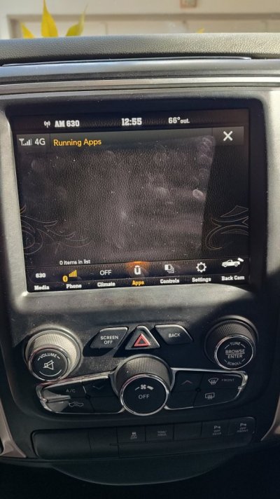

This is the apps page I was talking about. There is nothing there. When I was test driving the truck, it had several apps on this page. I see in the forum that I'm supposed to be able to go to the app store and download apps. Nowhere on the UConnect do I find the App Store.

I was looking for that first screen just before this one. There should be a section for "Navigation" on that dealer mode screen if your radio has Nav with a map database version in it. I see what you mean about the apps, that should be populated with at least 2 pages and not blank (we'll get to that after confirming NAV).

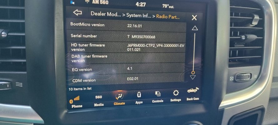

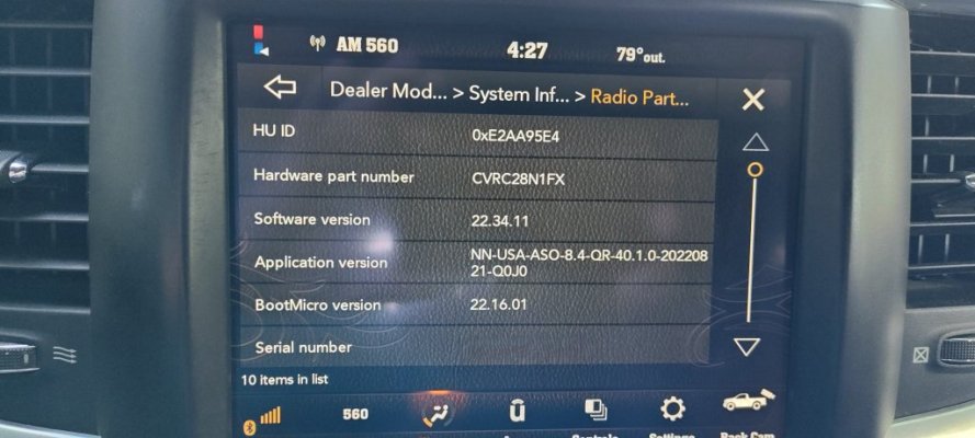

The photo of the 4 options is like the intro page then I select the Radio Part Information. The next photo is the second page to the Radio Part info.
They may have replaced it with a non-NAV UAS radio from the screens. I'd need to see the part number on the back or any paperwork they may have provided you to confirm. I would confirm that before proceeding with any fix...if you paid for a truck with NAV they should provide a truck with NAV.
If this is in fact a NAV radio the lack of all Apps may be the reason the NAV info is also missing, but I'd confirm the part number on the back first.

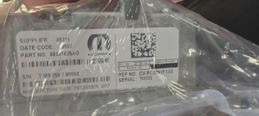

Does this help?

Does this help?

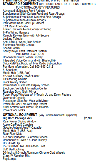

Yep, looks like they gave you a non-NAV radio (UAS). You can use this site to enter your VIN and see the trucks original equipment listing.
