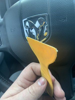

My truck did this to me once and since then I’ll never roll my windows down till I pass my little friend along the bottom of the window first. ThiS should come with every ram!image.jpg

My truck did this to me once and since then I’ll never roll my windows down till I pass my little friend along the bottom of the window first. ThiS should come with every ram!View attachment 192612
I use one of them fake credit cards that I kept when they tried to hock their card on me.
