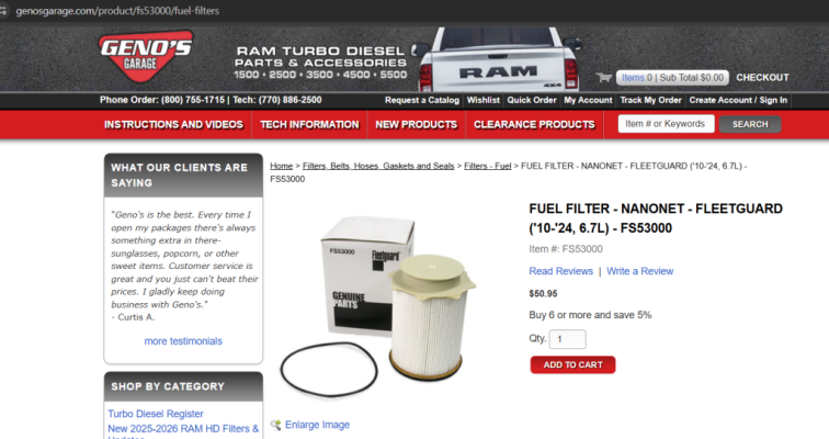

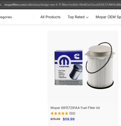

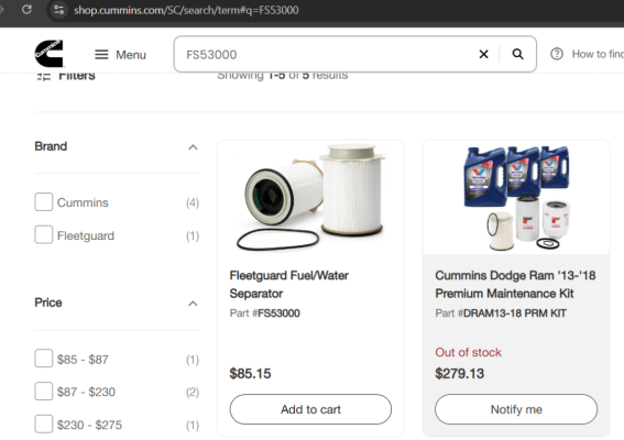

Wow, you must get some really large discounts.
I don't know about that poster's situation or this particular filter, but if you can qualify for fleet pricing you'd be surprised how many things are suddenly half off or better direct from OEM. It's pretty comparable to wholesale. OEMs *generally* won't compete with their retailers by offering lower direct prices to retail consumers, but like everything there are exceptions.
NAPA is the same, or at least it used to be, even at the store. I have no idea what the qualifications are these days, but sometimes it's as easy as having a business credit card and a sympathetic sales manager. When I still had a Ford diesel I had fleet pricing due to my affiliation with the city fleet and it was a huge difference.
nlambert182
Dec 28, 2022
2,657
4,646
Huntsville, AL
We had a tiered pricing model at the dealership I worked for. Level 1 was a walk-in (highest price), 2 was your average small business owner (1-2 trucks) that would get general maintenance done on site, 3 was someone with a fleet who did all their own work, and 4 was a fleet where we did all of their work.
The difference was about 40% from a Level 1 to a 4. We were the Cummins dealer, but on average we were similarly priced to other 3rd party resellers that sold genuine OEM. We were rarely much higher.
