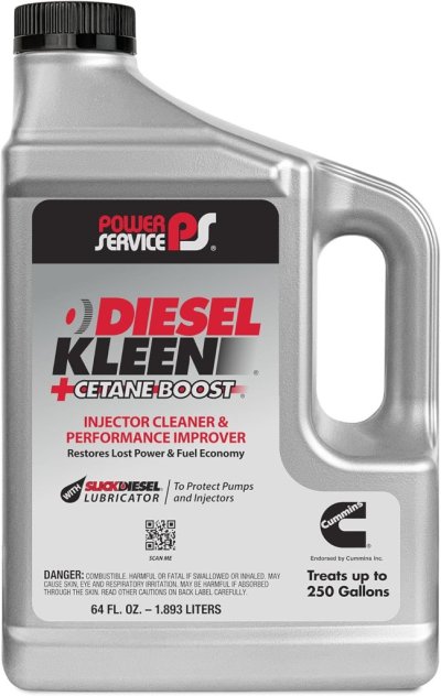

I use Archoil 6400d system cleaner, then Archoil 6500 additive in every tank....
This one is endorsed by Cummins but makes no claim to clean the DPF
Watch this U-tube video I found and watched it, I was surprised to hear that the top 2 diesel additives are Archoil and Hot Shot every day additive. FYI Power Service paid Cummins to get there approval to put their name on there bottles just like Valvoline did for there diesel oil, just because it has Cummins name on the bottle does not mean its the best...
